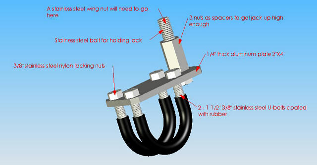

Here is a simple idea I stumbled across for a custom Hi-Lift mount on a tubular bar.

I just got 3" U bolts, wing nuts and aluminum flat plate at Home Depot... works well.

Sky, you may want to pick up the hex sleeve shown in the pic also. This helps to push out the jack a little so things fit on better. Just about any hardware store carries them. If you decide to get them, make sure they will thread onto the end of the u-bolt. :scratch:
