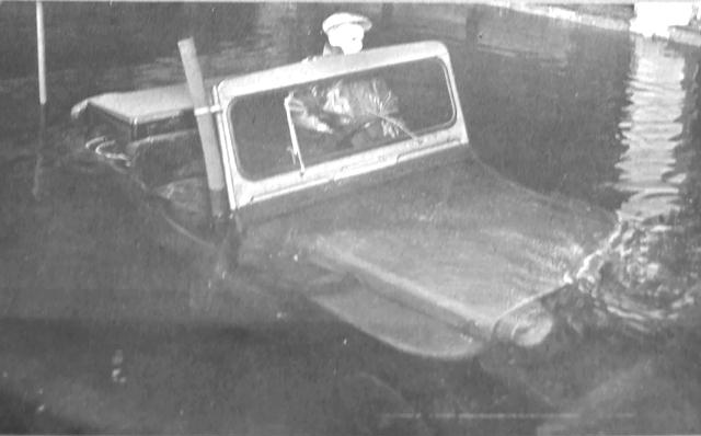

Go here to view all the info it's good stuff, it even shows a Jeep under water & the guy is still driving it.
Awesome Flat fendered Jeep underwater

Now that is what I called a true Fording & Underwater Ventilating System!
Excellent find.

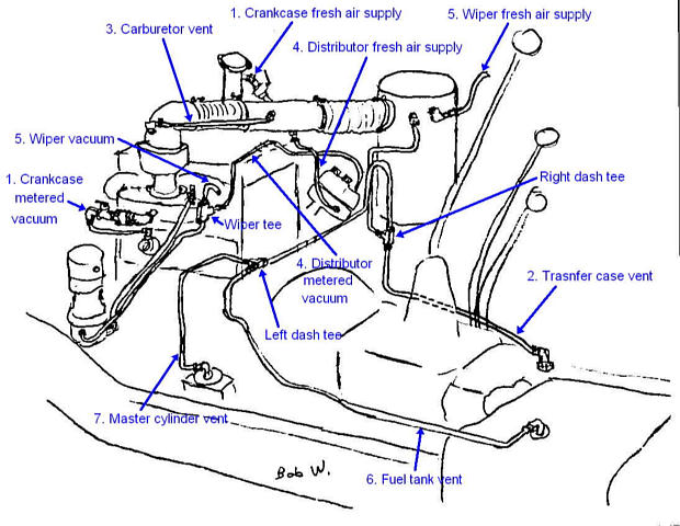

Nice photo !!!! Is these the same type of system that used to be controlled by a lever on the dash????( Military Jeep ) And some civilian models had from the early to mid 40"s ???
Does anyone put out a kit like this now a days???
Yes, there is a lever fromwhat I've learned.
Yes, I just bought one from Midwest Military for the conversion project. If you want one you will have to adapt it. You can use the main intake hose & go right into the yJ air box & seal it w/silicone & make sure there is a good rubber seal on the lid. As for the exhaust u will have to weld a plate like when a header bolts to the pipes & run all your vent lines up as high as U can get them. Water proofing the wireing etc. helps.
Hope this helped,
RollBar
P.S. U can C A pic of the heavy duty hose over on the conversion project page.
