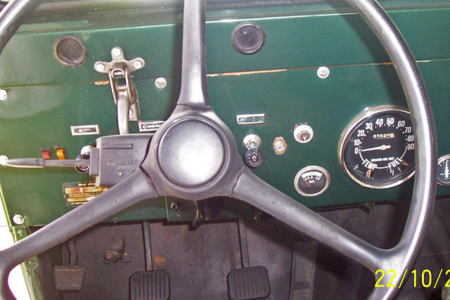

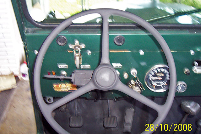

Epoxy from home depot worked great. Due to the depth of the cracks, I had do several passes, but after some sanding and black paint, it looks pretty good for the price! Too bad I don't know how to post pics, I have a before and after..

Send me the pics at the JOM email address that JT has set up for this. I'll get the pics from there and post them for you.

I painted it bar-B-Q black. fits rest of Jeep. Will send pics to you, thanx

Really good work from the pics you sent. :whistle: (Btw, don't take pics with dates in them, that is for Rollbar and amateurs :grin:)
What type of paint did you use and did you seal the paint somehow :biggrin1:
When I did mine Scheller I gave it to someone else to paint that had a body shop. Needless to say that the paint rubs off a bit now with use but I kind of like the look because it does not look so shiny and new. With my Willys which it is not supposed to. My cracks were so thin that it was hard to fill in one area and I can barely see one now but not enough to do it again. Next time I'll open the crack a bit so it can fill in better. :bat:

thanx for posting the pics. I used Rustoleum flat black Bar-B-Q paint. I used the same paint for the engine compartment some time back, and it has worn quite well.
I like the flat black much better than gloss. I did not seal it. If it starts to sweat off, I will put something on it. Actually, the picture picks up the light and shows the seams a little. Looks better in person. Not perfect, but for $5.00, I'm happy. As far as the date, it's wifes camera, don't even know how to turn off the date, besides, I am an amateur!
